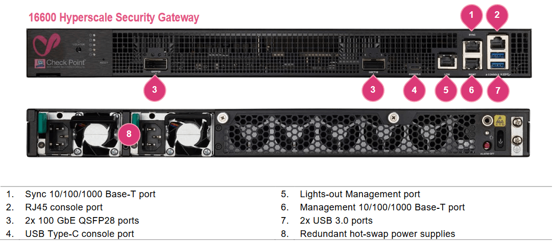

  • 2x 100 GbE QSFP28 ports
  • 2x CPUs, 24 physical cores, 48 virtual cores
  • 1x 480 GB storage
  • 2x AC power supplies
  • 128 GB memory

  • 32x 100 GbE ports (MHO 170)
